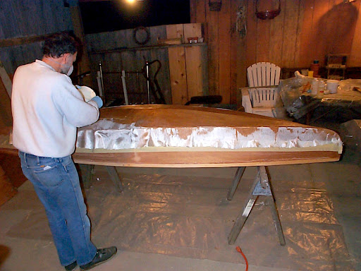

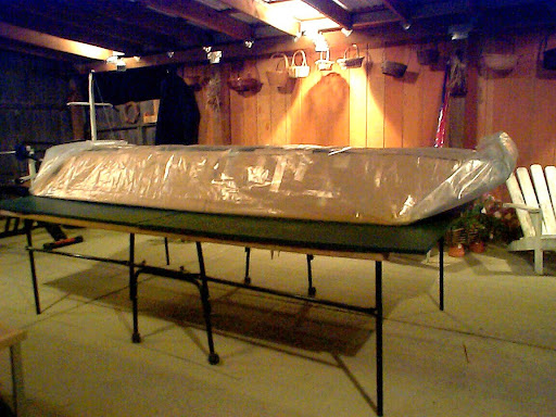

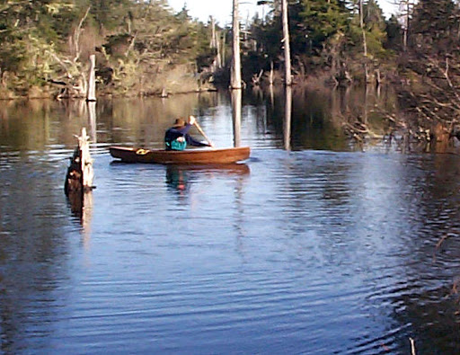

    Sounds like a great project. I built a few cheap boats everything from a few cardboard canoes and a SOT.
    One of the best projects began with a poster board model (seen in foreground left)
    that turned into a solo canoe.
    Note the bow and stern are out of the water with the severe rocker.
    If you need a little larger cheap boat see my blog titled a modest proposal.

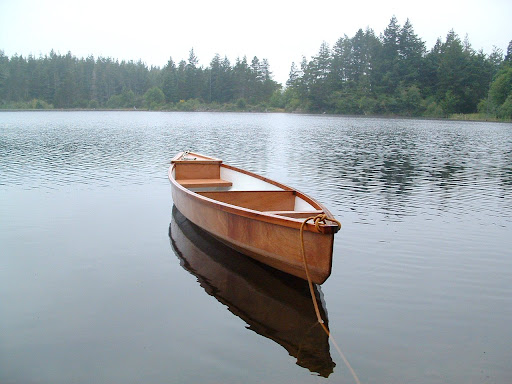

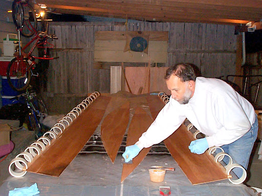

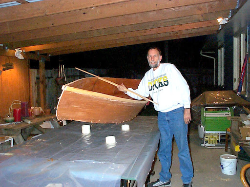

    i was thinkin 5'10" long, 1'10" wide with steep sides up to about 2'8" deep. a keel running the entire length of the bottom, a rocker of about 3", as pointy as i can get it, and... wait for it... 3mm ply!!!
    Your dimensions confuse me. It sounds child size. This one is 10'6" and a 29" beam. It was designed for teaching children. However I have had two adults in it. I replaced the thwart with two thwarts about 4.5 feet apart. One acts a back rest and the forward one I brace my feet on. The twin thwarts permit easy attachment of an alma.
    finished it weighs about 24 pounds and was made with 3mm ply wood.
    The thin plywood was sheathed up to the water line with glass cloth.
    While lifeguarding with this in the surf. I had a child broadside me with a kayak. The cracking plywood made a sick sound but the damage was minimal. The hole/crack was about 6 inches by 3 and at the water line. I pushed the broken section back into place and continued the day of surfing. The patch was a section of glass on both sides. It never seemed too thin as long as it was supported by the water when you stand in it.
    You can see this has a lot of rocker. The thought was to have it spin easy. When you want to go straight, you sit back to make the sharp V act as keel.
    My thoughts are your design is too narrow, 22" and too high 32" and possibly too short5' 6". I would swap the depth with the beam.
    This hull has only 1 foot of plywood on the sides. You don't need a keel if you have a deep V. One boat I built with a 3/4" keel on an 18' hull was impossible to turn. I shaved it down to make it usable. I would have removed it but hated to have all the holes to patch removing it would have left.
