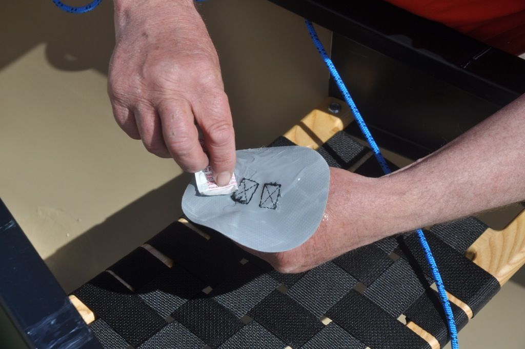

    After fitting the cords down the sides of the boat, next is the fitting of D rings as extra security for the air bags. Having chosen the spot I draw around the vinyl D ring patch and then lightly sand both the boat and the underside of the patch.
    Vinyl Bond is applied to both the boat and the patch and allowed to dry slightly before pressing together. I follow the instructions on the tube!
    Applying vinyl bond.
    An even coating.
    Making sure it’s firmly in place.

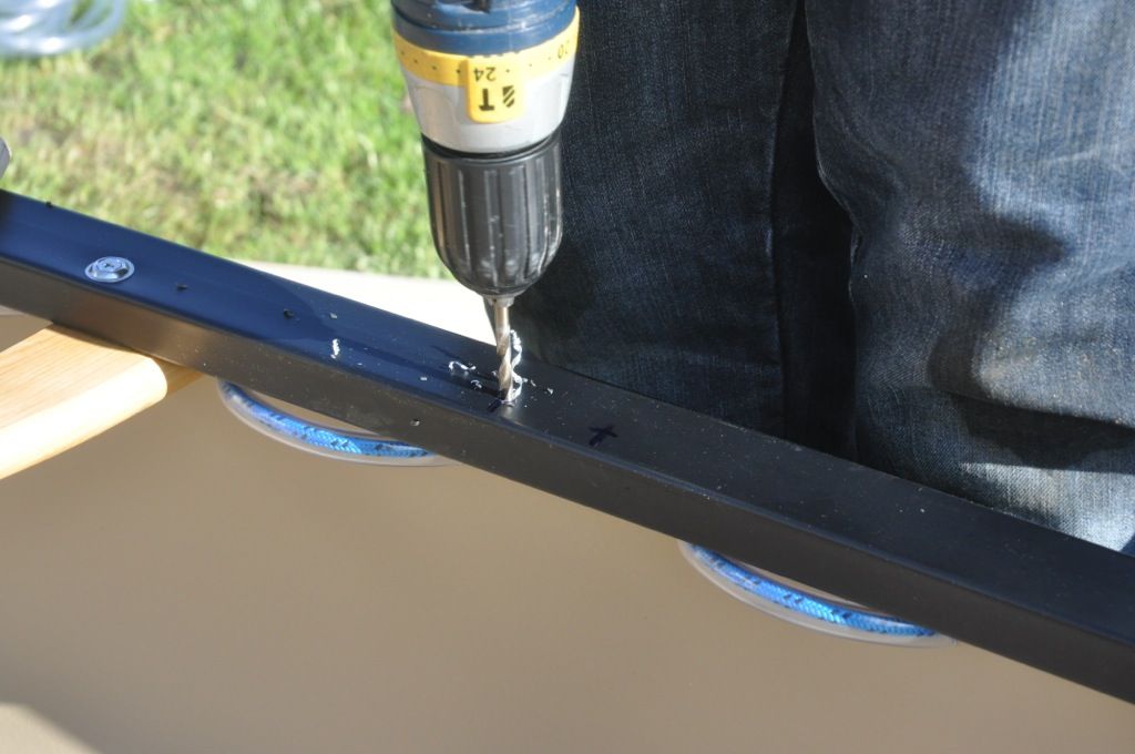

    Adding A Kneeling Thwart
    The addition of a kneeling thwart requires the final bit of drilling. The spacing of the cords (above) was pre-planed to accommodate this. The kneeling thwart will get you into a different part of the canoe for better trim and allows good control when paddling solo.
    Drilling holes to fix a kneeling thwart.
    The only awkward thing is getting a roughly correct angle on the drill holes through the kneeling thwart. They are running at an angle, not right angles. I do it by eye.
    The strengthening thwart to the left will be taken out once every thing has been finished. The kneeling thwart provides the additional strengthening in its place.
    Attaching the kneeling thwart. The strengthening thwart to the left will be removed.
