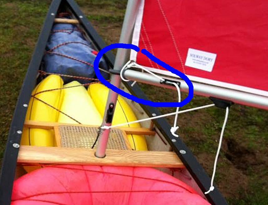

    After much deliberating over sailing set-ups, I decided to have Solway Dory do the lot and fit-out a dedicated sailing canoe. Cost more than I had intended to spend but the hours saved faffing around more than justify the money spent. The main advantage being I took a standard canoe (Peace River Cruiser) in to the workshop and the next day picked up a sailing boat
    Been out couple of times, quick to rig and lets me go anywhere I want on the lake! Ace!
    Only prob I've had so far is with the rudder popping out of mount at the back- this lead to the top mount becoming bent. I've tried to bend it back- any suggestions? Other than this... very happy indeed!

    The only way that the rudder could have come apart in use is that you put it on wrong. The pivot pin goes through the gudgeons on the rudder and the rudder fittings on the canoe. If the fittings on the rudder go between the fittings on the canoe the pin holds them together and the rudder cannot lift off. You must have put the rudder fittings on top of both fittings on the canoe. The rudder can then lift up and the pin come out of the bottom boat fitting, The rudder is then only hanging on the top fitting and will have bent this. We can send you another top rudder fitting, if you cannot straighten it. E-mail me and we can sort this out.
    The fittings that we put on your canoe are the stainless strap fittings as your Peace River Cruiser has a very narrow stem. They are just bolted on through the sides.

    Question for Dave though. Dave I noticed that his boom has an extra cleat attached near the mast. Is this to enable the rig to reef on the hi-spec Expedition 35's or is it for something else? Just wondered.
    The Tack doesn't seem to be pulled down in any way tensioning the Luff?

    The extra cleat is for a downhaul, and Adventure 7 has missed it out. There is a separate line from the Tack and instead of it going to a hook on the mast and being tensioned with the halyard like yours, it can be tensioned separately. The high spec Expedition rig has more bits on it to make it more controllable, but at an extra cost. With your sail, the downhaul is of fixed length and is tensioned with the halyard. With the reefed sail you can set it at different heights when reefed as you have spare mast above the sail, so the adjustable downhaul alows you to tesion the luff whatever height you raise the sail.
