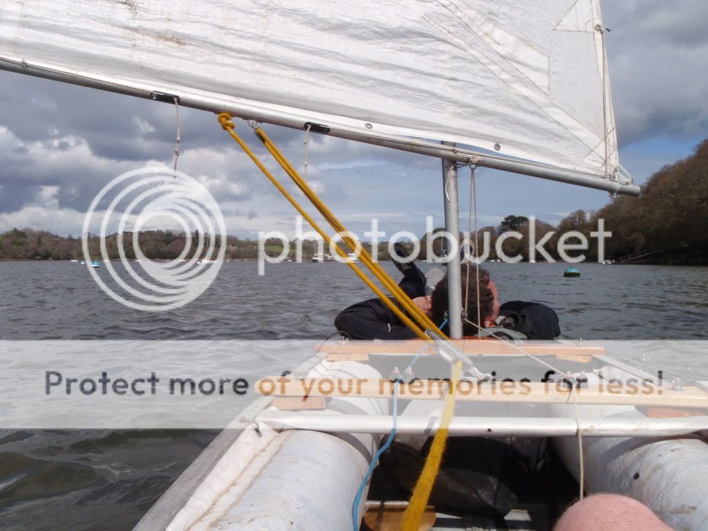

    I am down in Devon tinkering with my Grumman, I know someone in the OCSG has a Grumann with the leeboard bolted through the hull. I think they were at the Coniston meet,but I can't remember who they were. Have you got a close up of how that was achieved? I want to dispense with my S-D leeboard thwart to make the set up simpler.

    Mmm, I was thinking of some sort of shaped wooden block on the outside of the canoe to give a vertical edge for the leaboard to bolt against and something similar on the inside for that to bolt onto, but with what Keith and Dave say its now obvious that would just put the shearing forces on the hull skin to the edges of the block, even if that method avoided pulling the bolts through the hull. My previous attempt at securing the thwart used a single coach bolt through the thwart onto wooden clamps the gripped the underneath of the gunnels
    but the thwart tended to slip.Mind you it had the combined forces of the downhaul the halyard and the sheet bridle put upon it. I am most likely to sail it with the bermuda rig in the future so maybe it won't be an issue.What might still be a pain though is the big rooster tail the leaboard put up which found its way over the gunnel
