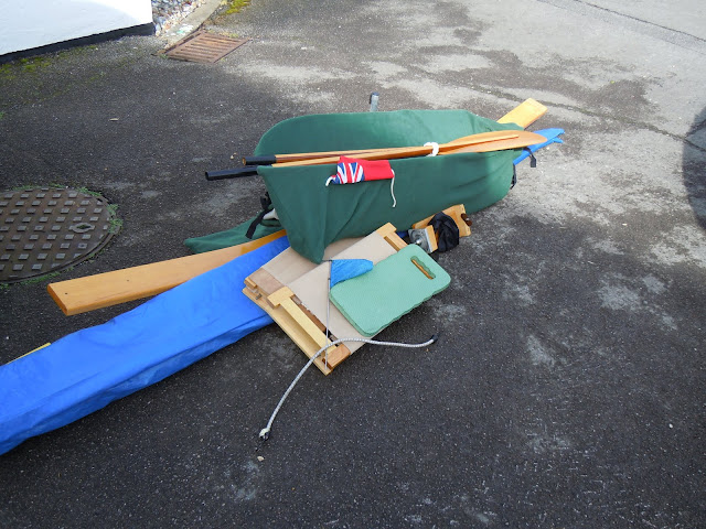

    here's the gear bag in the Shearwater cockpit - made to measure
    All the bits to go in - the only downside of a sailing canoe with outriggers:
    floats, outrigger, rudder, leeboard, leeboard bracket, two sliding seats, one cushion and split paddle
    Now neatly stored in the bag - wonderful, order at last
    Now with rig and boom ready for cover
