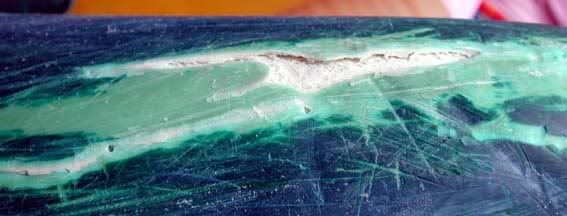

    As I said the Pyranha had a split – well several really.

    I was advised by Dave Crooks at Endless River – guess whose Skid Plate kit I used?? – to drill the ends of the splits to stop them running further as the hull flexed in future use.
    http://i184.photobucket.com/albums/x...ofDSCN4595.jpg
    I used a small grinder to explore the cracks.
    http://i184.photobucket.com/albums/x...ofDSCN4601.jpg
    I then ground off the very flaky pieces of outer plastic shell but tried to avoid getting into the foam base or taking too much of the unstuck plastic flaps off. I decided that dabbing some resin under the flaps would help stick them down.
