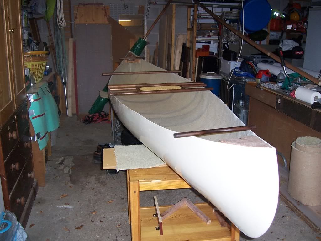

Canoe arrives and rough laying out of parts:

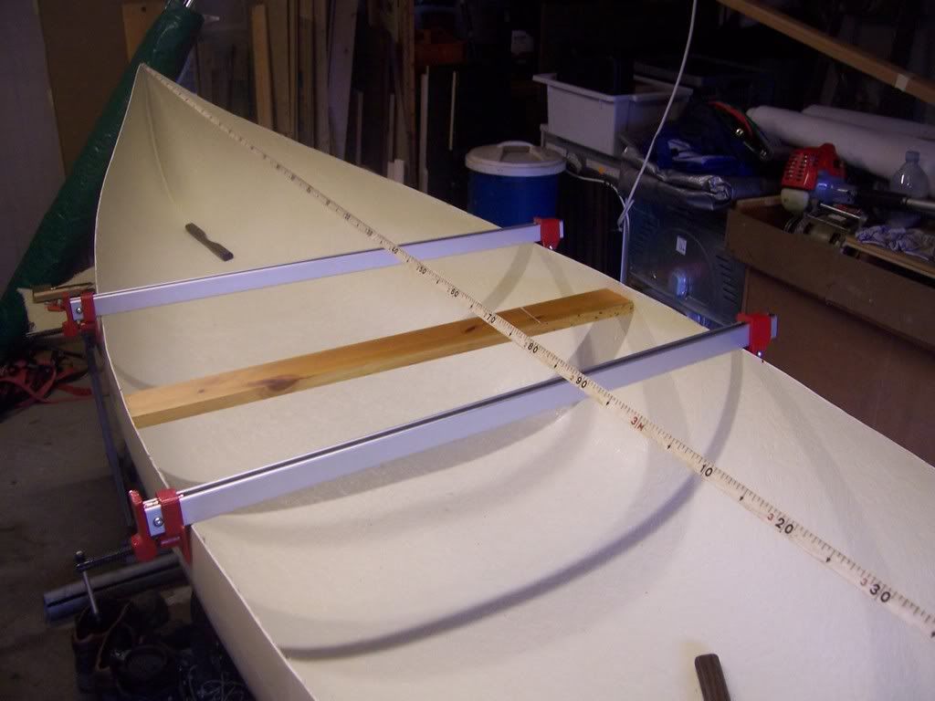

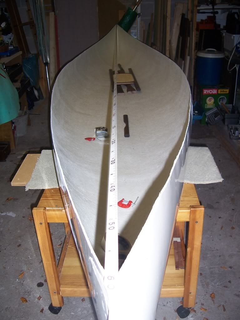

Then I measure the hull down the centre line (14ft 10 and a half inches):
Find and mark the centre point and then fit a temp thwart at 33 inches to ensure correct width. It is glued in place but constantly falls off so is glued about 8 times a day!!!:

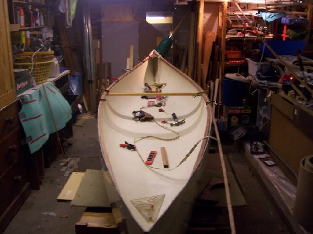

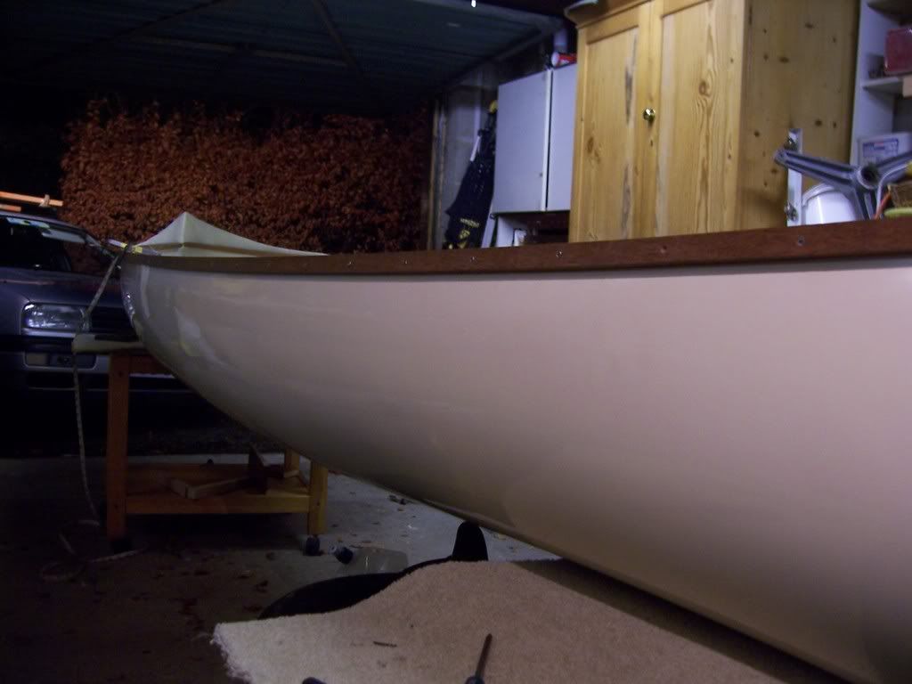

Now comes the fitting of the gunwales:
Now I think everyone knows the problems I had with this. Firstly the SS screws were pure pap. Even with multiple drill bit changes and even incremental drilling it still left me with either stripped screw heads or even worse with broken heads
Then came the biggest problem, I could not bring the gunwales up to meet the top of the hull at the bow and stern without it twisting horribly. I managed to get it to 4.5 cms and left it at that. I still get a good upturn on the hull but not as much as everyone else.
The last problem was the deckplates. My initial thought was fit gunwalwes first and then fit deckplates, however this was very hard. In fact it led to them dropping at the back whilst fitting the gunwales through it where the outer gunwales screws directly into the deckplate. I learnt form the first and with the tip from Stu I pre-fixed the second deckplate before fitting the gunwale. This made it a lot better
But after a few days and much swearing they were done, although this shot is taken half way through:

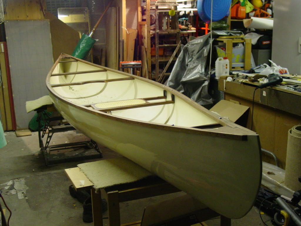

Here it is in all its glory, well nearly the seat bolts need tightening and it to be cleaned out:

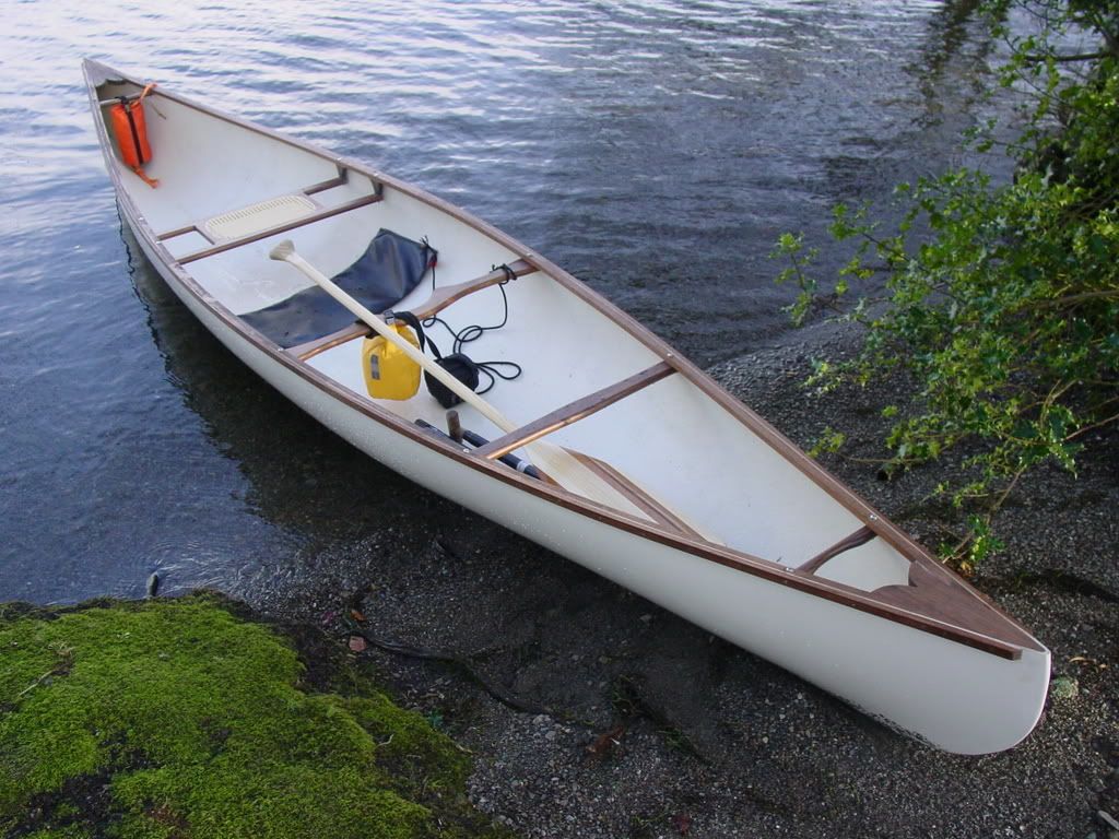

I am very happy with the canoe, and here it is on Windermere:
