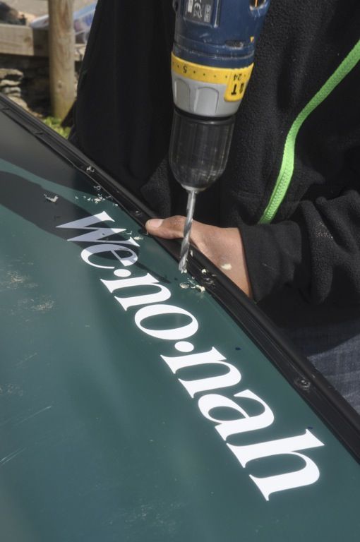

    Because I want to lash in airbags and other kit we are marking up the side to thread a rope all the way down the side.
    Marking up the side to thread a rope all the way down the side.
    I use a three-inch spacing in the airbag area and a four-inch one elsewhere: many others will use an equal spacing but this is what I have settled on over the years.
    I need the holes far enough below the gunwale to make it useable on the inside but I don’t want to drop it too far as solo I often use the canoe heeled right over and there will be some seepage through the holes.
    The width of the tape measure seems about right as a marker.
    With a steady hand Lina doesn’t bother to put masking tape on the Royalex but just drills away. Another hole mark is above the ‘n’ of nah.

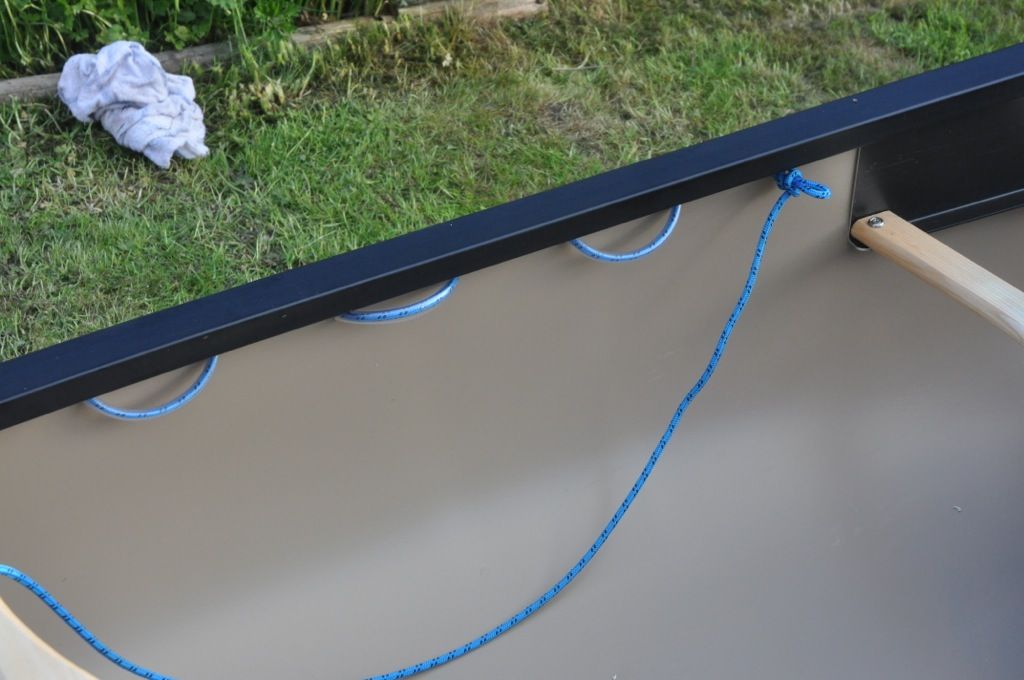

    Feeding the cord through the holes.
    In the airbag section the cord is looped through the holes and then tightened but leaving a bit of slack to make the inside loops usable. The cord is 5mm climbing cord.
    For the middle section we are adding small sections of plastic pipe to make loops on the inside of the boat. My three-year-old daughter Maya Rose is keen to help.
    Maya Rose helps with threading the piping.
    Looped cord with plastic piping on the inside of the boat.
    The final knot is on the inside of the canoe as I want the outside clean and tidy. The blue rope is trimmed off close to the knot.

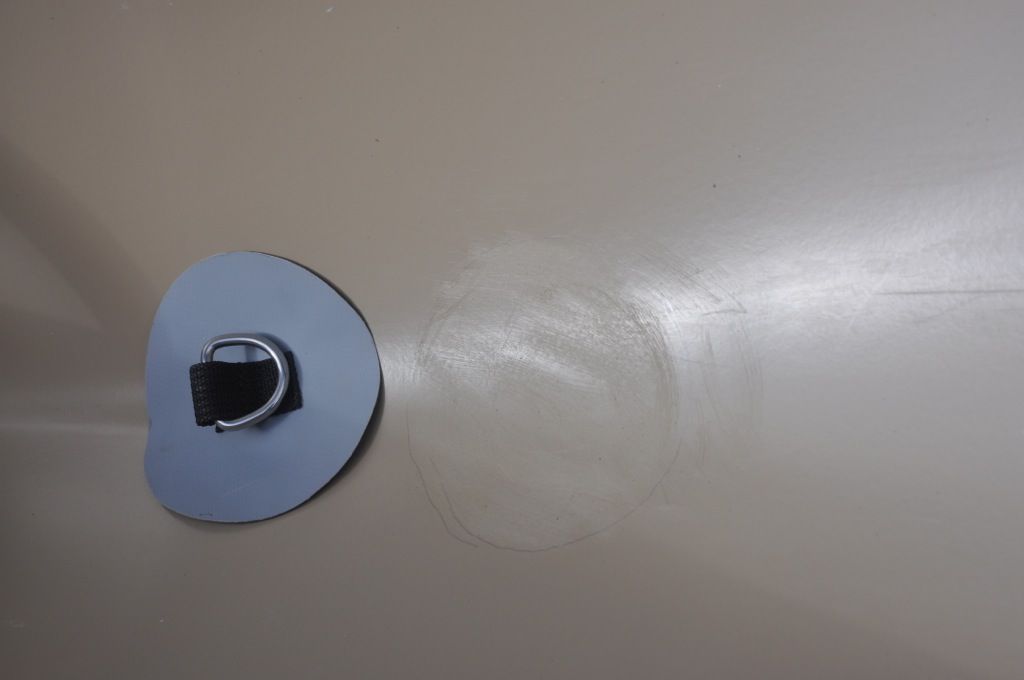

    After fitting the cords down the sides of the boat, next is the fitting of D rings as extra security for the air bags. Having chosen the spot I draw around the vinyl D ring patch and then lightly sand both the boat and the underside of the patch.

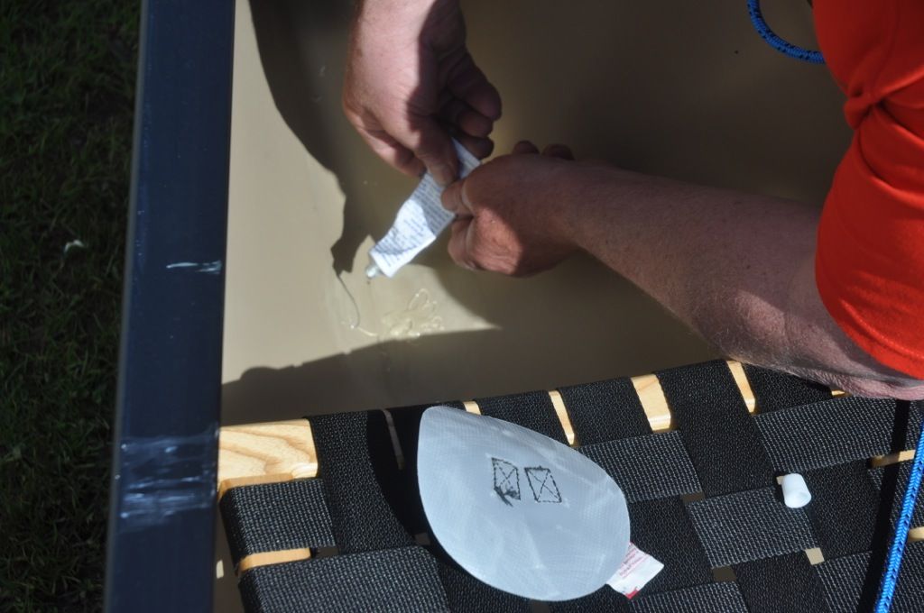

    Vinyl Bond is applied to both the boat and the patch and allowed to dry slightly before pressing together. I follow the instructions on the tube!
    Applying vinyl bond.
    An even coating.
    Making sure it’s firmly in place.
    View of the rear of the boat. The D-ring is situated back under where the airbag will be.
    N.B. In the above photo, you’ll see that the D-ring is situated back under where the airbag will be and not directly at the end of the airbag. A tape will go from there along the floor around the airbag and then back to the carrying handle to fix the airbag in place.

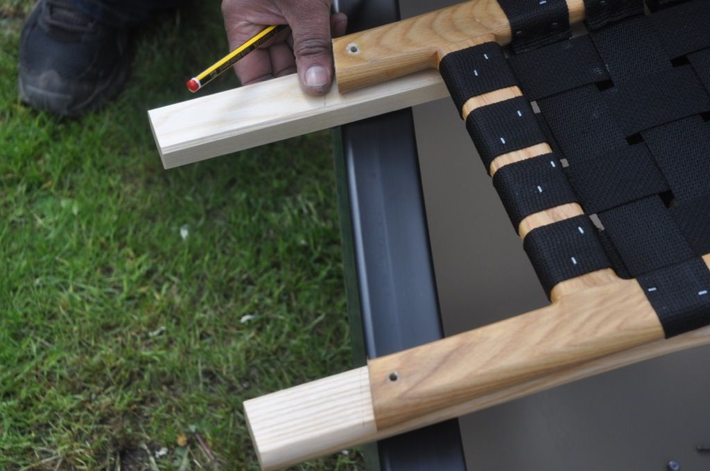

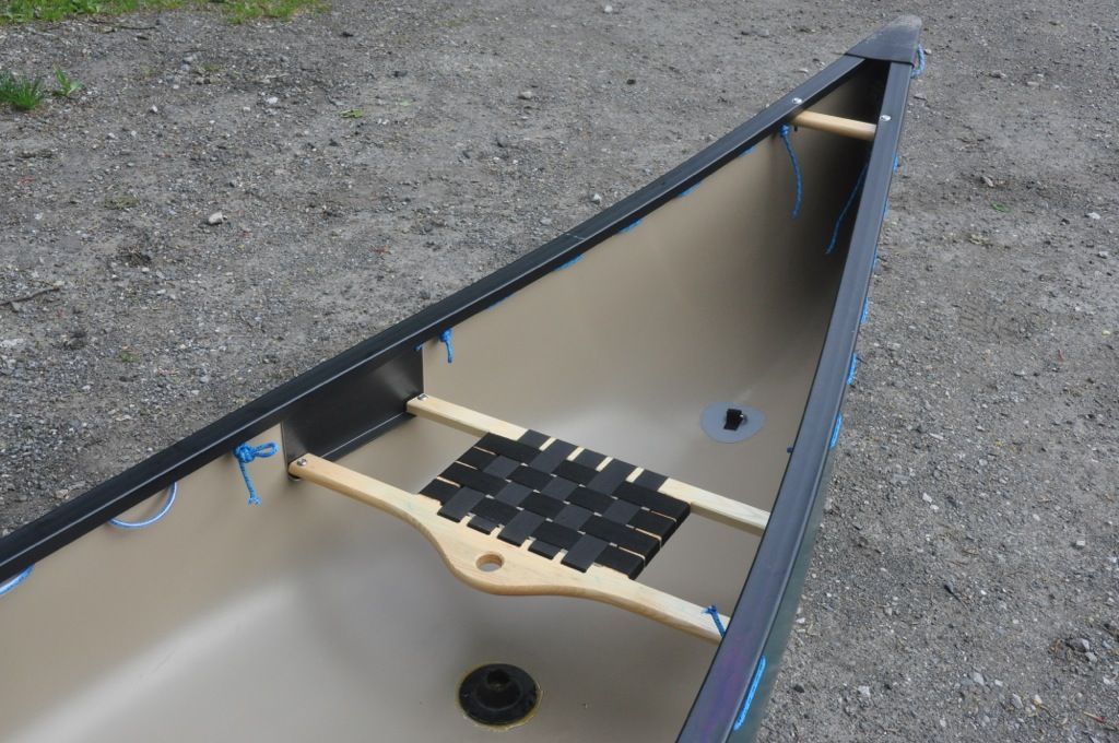

    I usually have a small sailing rig in my boats so I need a mast foot and an attachment on the rear of the bow seat. Sometimes I have added a piece of wood below the seat but Endless River have a neat seat that does the job so I am replacing the original.
    Endless River seat with integral mast hole is very neat and will replace the standard seat in this boat.
    Using the original as a template for the seat bolt-holes on the new seat.

    Finding a good mast foot is a bit like the search for the Holy Grail. Some use a properly shaped piece of wood.
    Years ago a friend of mine spotted these black rubber raft inflation valve mountings. Hard to get hold of – and my stockpile is running low – they do the job very well. They come with a metal insert which the valve screws into, this has to be cut out with a hot knife.
    Improvised mast foot using a raft inflation valve mounting. Make sure you use the right epoxy!
    Because of the stress on the mast foot I am using a two-part epoxy (do check that it is ok with Royalex before using: I have known someone melt their boat using the wrong epoxy).
    Again the surface of the canoe and mast foot are sanded and prepared.
    The surface of the boat has been prepared for adhesion of the mast foot
    Mast foot in place and boat coming together.

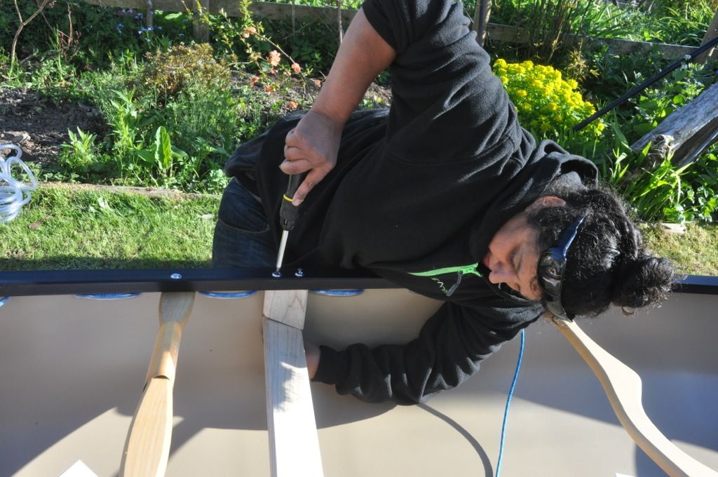

    The addition of a kneeling thwart requires the final bit of drilling. The spacing of the cords (above) was pre-planed to accommodate this. The kneeling thwart will get you into a different part of the canoe for better trim and allows good control when paddling solo.
    Drilling holes to fix a kneeling thwart.
    The only awkward thing is getting a roughly correct angle on the drill holes through the kneeling thwart. They are running at an angle, not right angles. I do it by eye.
    The strengthening thwart to the left will be taken out once every thing has been finished. The kneeling thwart provides the additional strengthening in its place.
    Attaching the kneeling thwart. The strengthening thwart to the left will be removed.

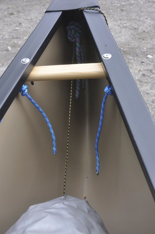

    End Loop Considerations

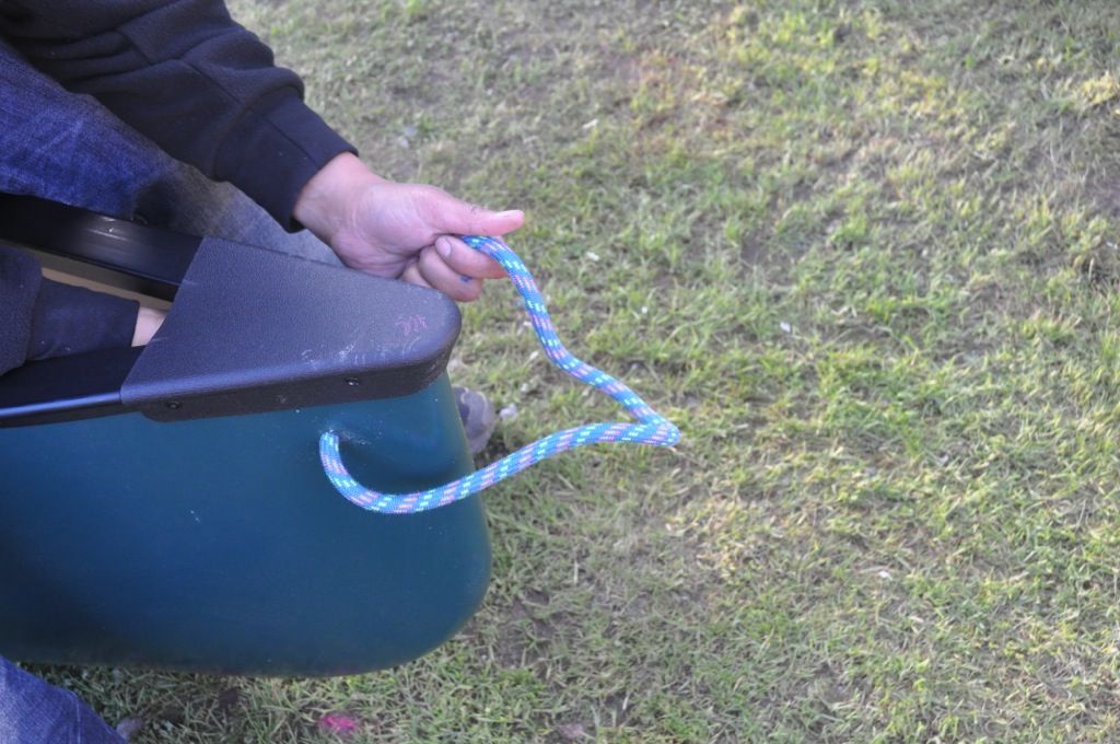

    I like substantial end loop in case of a boat pin where I am going to need ropes and pulleys to remove it. This is 9mm climbing rope.
    Fitting an end loop of 9mm climbing rope.
    I want no risk of pulling the rope through the Royalex in an extreme situation. In the photo above, note the substantial spacing from the end of the canoe and from the end plate. When the end-loop is tied it should end up small enough that anyone would struggle to get a hand into it in a white water rescue. Getting a hand trapped whilst swimming down a rapid is very bad.
    The knot on the inside is a simple overhand knot and, in the photo, has yet to be tightened. Even with this knot, the rope has a breaking strain far greater than most throw lines.
    Tieing off inside, using an overhand knot (still to be fully tightened in the photo).
